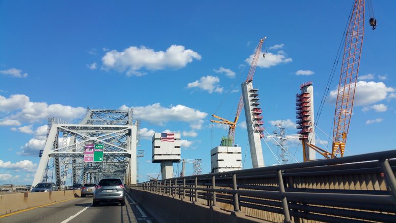

The new Goethals Bridge consists of twin spans rising immediately south of the old cantilever structure. In tune with the current trend, the engineers used a cable-stayed span, similar in principle to the new bridges replacing the Kosciuszko and Tappan-Zee. Road-supporting cables fan out diagonally from central anchor pylons, like strings upon a harp. In comparison to the traditional suspension bridges, the cable-stayed version dispenses with massive and expensive ground anchorages at either end, and allows for much greater road deck stiffness (though the deck has to be stronger in order to resist greater horizontal compression loads). In general, this design is ideal for mid-length spans, since anchor pylons must rise very high for any bridge of significant length.
Credit: Goethals KWM
Unlike the new Kosciuszko Bridge, where anchor columns rise vertically, the pylons of the Goethals are V-shaped. Interestingly, the Goethals pillars are accessible with scaffold stairs that rise between each pair, in contrast with the Kosciuszko where the pylons are reachable only by vertically moving platforms. Each of the two spans would boast 72 stay cables, each one composed of tightly-wound steel wires encased in a flexible protective cover.
The pylons of the south span, where construction is further along than on its northern counterpart, were topped out around a month ago. On the Jersey side, the supports for the double bridge rise from a shallow channel, yet the demolition of a channel-adjacent industrial loft structure built before World War II was required in order for the project to proceed.
The new spans would feature three 12-foot-wide lanes in each direction, flanked by a 12-foot-wide outer shoulder and a 5-foot-wide inner shoulder. The northern span will feature a 10-foot-wide bike and pedestrian path, restoring foot access across the kill since the original five-foot-wide paths across the old bridge were dismantled. They will maintain a 138 foot clearance above the water, similar to the current bridge. Both structures are on track for late 2018 completion. In all, the project is expected to cost around $1.5 billion. The Port Authority expects the construction phase to create 2,250 direct jobs, pay a total of $224 million in wages, and generate $872 million in economic activity for the region. The investment will be made worthwhile thanks to increased vehicle capacity, decreased driver hazards, and an eliminated need to sink funds into continuously repairing an aging span.
