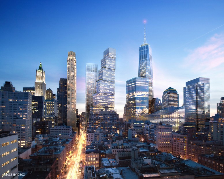

The new World Trade Center, image from Silverstein PropertiesThe new World Trade Center, image by DBOX
YIMBY sat down with Bjarke Ingels to talk about his firm’s design for 200 Greenwich Street, aka Two World Trade Center. Despite public outcry following the change from the Norman Foster version of the tower, BIG’s innovative and forward-thinking building will truly respond to the human needs of its tenants, while also punctuating the Downtown skyline with a 1,340-foot take on a classic ziggurat. We’ve also obtained a few additional renderings of the soon-to-be icon’s impact on the cityscape.
YIMBY in bold.
What’s the concept?
Two World Trade is almost like a vertical village of bespoke buildings within the building, that also can be seen as a single tower. The program creates large floor-plates for the studios, medium-sized floors for the newsrooms, and more classic tower floor-plates for the spec tenants.
We tested out various kinds of massing — different types of logic — so we ended up saying it’s ok that the building’s components have different proportions, and are then stacked on top of each other. It actually has an inclination towards One World Trade Center, so the two towers — even though they’re not twinning — by having a mutual relationship, the space between them is parallel, although at an incline.
From the memorial, Two World Trade is really one of the group of towers; it has a vertical corner, but then it has an almost leaning aspect to it. It feels like it’s a completely straight-forward tower, but then there’s something weird going on, that it seems to lean with One World Trade Center.

This would be the first tower in New York that cantilevers several times over, right?
Yes. Typically contemporary towers have extruded floor-plates, then something interesting at the top, and something interesting at the bottom. Here we tried to maintain the same logic throughout the entire building; from the Memorial it’s a very disciplined silhouette, but from Tribeca it becomes a more abstract, active building.
