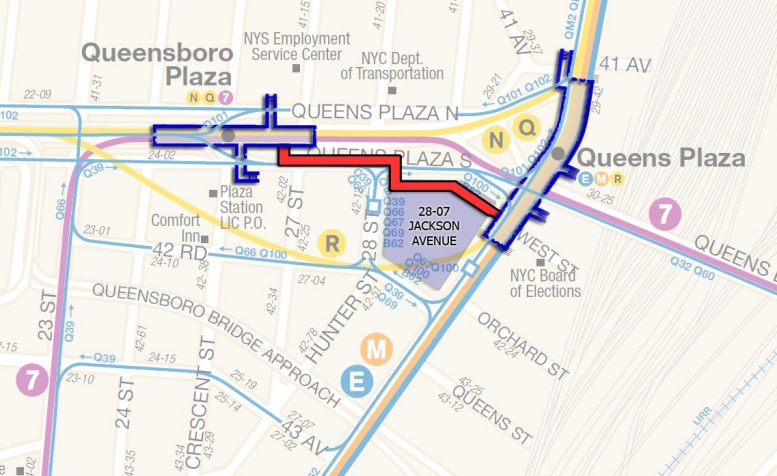

YIMBY suggestion for Queens Plaza-Queensboro Plaza connector via the proposed complex at 28-07 Jackson Avenue in Long Island City. Photos by the author unless indicated otherwise.

The underground passage (red) would run from Two Gotham Center, right, to the median under the Queensboro Plaza platform, to which it would connect via stairs and elevator (yellow)

The west end of the complex sits just 330 feet away from the elevated platform of Queensboro Plaza. If measuring from the corner of the H&R REIT-owned Two Gotham Center, which the developer website describes as “on the doorstep of Long Island City’s most important transportation hub,” the distance drops to 210 feet to the platform, or 430 feet to the nearest station entrance. From that point the passage would continue as a tunnel under Queens Plaza South, spanning one block, or around 250 feet. At 28th Street it would feed directly into the elevated station mezzanine via a stair/escalator/elevator bank, placed within the median underneath the elevated structure.
Until such a passage is constructed, a commuter transferring from Queens Plaza to Queensboro Plaza would have to ride one stop via the E or the M to Court Square, make a 1,000-plus-foot-long underground hike to the elevated 7, and then ride one stop in opposite direction. Alternatively they may choose to exit the station, cross two intersections, and then re-enter the system with an extra fare.

  8. An elevator to the mezzanine of the Queensboro Plaza station in the median of the elevated structure likely isn’t structurally possible – the top of the elevator shaft would vertically intrude into the 7-train track above. Plus, to make the station ADA-compliant, you would have to add a second elevator between the mezzanine and the two platforms above; since the platforms are right above the roadway, the bottom of any elevator installed to the platforms would vertically intrude into the roadway space below.
