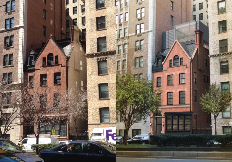

A charming little townhouse amongst much larger neighbors on one of Manhattan’s great boulevards will stay just that, for the time being. On Tuesday, the Landmarks Preservation Commission decided not to approve proposed additions to 890 Park Avenue, located on the west side of the street between East 78th Street and East 79th Street, in the Upper East Side Historic District.

The new plan is for a single-family home. The presentation was made by architect Shae Murdock of Chelsea-based Murdock Solon Architects. It called for a two-story rooftop addition with a terrace. It also called for reconfigurations on the rear and along the north elevation, where there is a space between it and its northern neighbor.

The stoop, which was removed sometime around 1907, would be restored – sort of. The below-grade entrance would be turned into a double-height entrance with four steps. Murdock said it would be “a gesture to its original identity of having a stoop.” Finally, there would be a full façade restoration.

Murdock referred to the currently five-story structure as a “holdout” and said it is now a “dark” townhouse in a “valley.” He said the proposal is “about bringing light back into the townhouse,” adding that it needs “amenities” like “outdoor space.”

It was in no way surprising that the commissioners had misgivings about the proposal. LPC Chair Meenakshi Srinivasan said the addition was “oddly perched” despite some space on the rear.
Commissioner Michael Goldblum suggested pushing the sixth floor back and having the terrace in front. Murdock said there are rear setback requirements that prevent that.
Goldblum went on to say that a visible rooftop addition would be acceptable at this house, even at the proposed height, but it would have to be pushed back. He said glass makes sense, but the execution wasn’t acceptable. Further, he asked the applicant to show more visibility studies.
Commissioner Adi Shamir-Baron said nothing should happen to the profile of the roofline. She also said that the applicant’s idea of engaging Park Avenue is “twisted.” She said the special thing here would be single-family use, not views.
Commissiner Frederick Bland has a problem with the complexity of the proposed additions and their two-part nature. As you can see in the renderings, the proposal is not a simple affair.
Commissioner Diana Chapin said the rear proposal should be simpler and said that simplification could actually produce more light. As for the roof, she said, “Something has to happen that doesn’t bring this large addition forward.”
Srinivasan said the proposal needs to be “much more muted” and the new front door should better match the historic condition.

In the end, the commissioners took no action, asking the applicant to re-work the proposal and come back.
