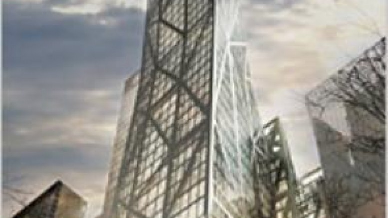

While 432 Park did not have to endure this process, Torre Verre fell victim to step 4, when Amanda Burden decided that she didn’t like the size of the building. NIMBYs had voiced significant concern over the building’s size, going so far as to declare the building’s vicinity–the heart of Midtown Manhattan–a ‘mid-rise neighborhood’. Originally proposed at 1,250 feet in height, Amanda Burden sliced the top 200 feet off simply because she didn’t like the design.
432 Park via CDN Architect
The beheading of Torre Verre shows how the zoning process is completely subject to opinions and whims. Although far from unanimous, most people agree that the Torre Verre–both the shortened tower and the original 1,250′ version–was quite beautiful. The breathtaking facade and sheer verticality of the building typify New York, and exemplify the qualities that make New York Gotham City. The design was sophisticated, elegant, and bold, and the 1,250′ version would have provided the Museum of Modern Art with a true architectural masterpiece, courtesy of Jean Nouvel. While Torre Verre was subject to opinion and whim, 432 Park was not. Either height filed with the Department of Buildings for 432 Park (1,379′ on some documents, 1,397′ on others) would make it the tallest in the city. Despite the size of the building, the design is completely bland–the tower is literally a monolith, with no variation in facade or floors as the building rises. 432 Park may be an incredibly skinny box, but it’s a box nonetheless. While the City Planning Commission believed Nouvel and Moma  had “not made a convincing argument that the design of the tower’s top, with the uppermost 200 feet of the building, [merited] being in the zone of the Empire State Building’s iconic spire,” (via The Observer) there are two other towers within a short walking distance that will both top the Empire State Building in height. Thus, the argument that 1,250 feet up is some kind of iconic zone for New York is moot. In the time since Ms. Burden’s decision, the number of buildings rising or soon to rise to the Empire State Building’s height has proliferated, with four towers now set to top New York’s most iconic structure (432 Park, 1 WTC, 2 WTC, and the Hudson Yards North Tower), and a fifth (225 West 57th) is also likely to surpass the ESB, although no official height has been released. Why should the Torre Verre have to suffer while these other projects are allowed to pass the Empire State with no debate at all? New York’s building climate has changed immensely since the decision on Torre Verre, and it would do justice to the city if the decision could somehow be revisited.

  1. Great Argument. Totally agree. Who says that she has the right to lop off the heads of whatever she chooses. There are other factors at play here.
  2. I’m with you. This would have been a top ten building globally at 1,250 feet. It’s bold design won’t be as majestic at 1,050 feet.
  3. Raise the roof!
    I believe the arguement was some nonsense about the shadow cast over Central Park. As if we will not see any other supertalls in Midtown in the near future.
  4. Thank you for the thorough explanation. I too was very disappointed when the original plan for the Torre Verre was turned down. One question though – how is it that 432 Park at 1400 ft falls within the zoning limits but Torre Verre exceeded the limits at 1250 ft ? Why are the zoning height limits so different for the two sites that aren’t that far from each other?

    • That’s a good question Kevin, unfortunately New York’s zoning is complicated to say the least. Even the Rail Yards will have at least three buildings standing in excess of 1,000 feet tall! New York’s response by claiming it would cast a shadow over Central Park??? Whoa…they don’t think ONE57 would cast a shadow? They didn’t think the new Nordstrom Tower would cast a shadow despite standing at least 1,550 feet tall? Heck, they approved of 432 Park Avenue despite it looking like a stick in the sky. New York could be a complicated place but their system is most complicated of all.
